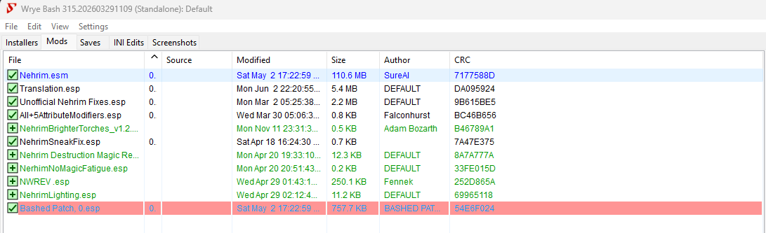

aside from what Hoxyd says, do you have any textures installed that maybe don't use an *.esp?
(that would be your explanation for the invisible mountain lions)
what mod is nwrev?
what mod is nwrev?
07.05.2026 12:49urst wrote: aside from what Hoxyd says, do you have any textures installed that maybe don't use an *.esp?
what mod is nwrev?
Well I'll be damned. Looking through Nexus I just remembered I was having problems with the unofficial fixes mod previously
08.05.2026 03:08Gamerdude535 wrote: Well I'll be damned. Looking through Nexus I just remembered I was having problems with the unofficial fixes mod previously![]()
there's probably some overlap with one of your other mods.
but if you get it to run without them all the better
not sure how ok Nehrim is with just removing them during the run, though -
if you keep having issues it might be better to start a new one (if my memory serves right it should be fine)
