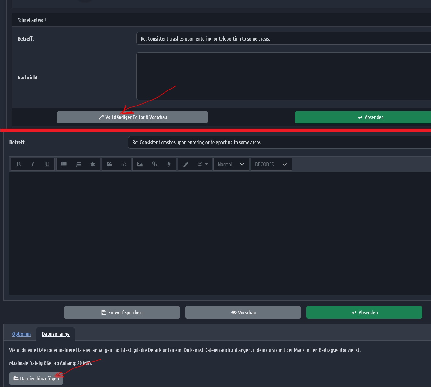

I already know the file location but how do you want me to send you the save data copies???
Put both into a ZIP archive and attach them to this post.
Here we go I think I did this right
