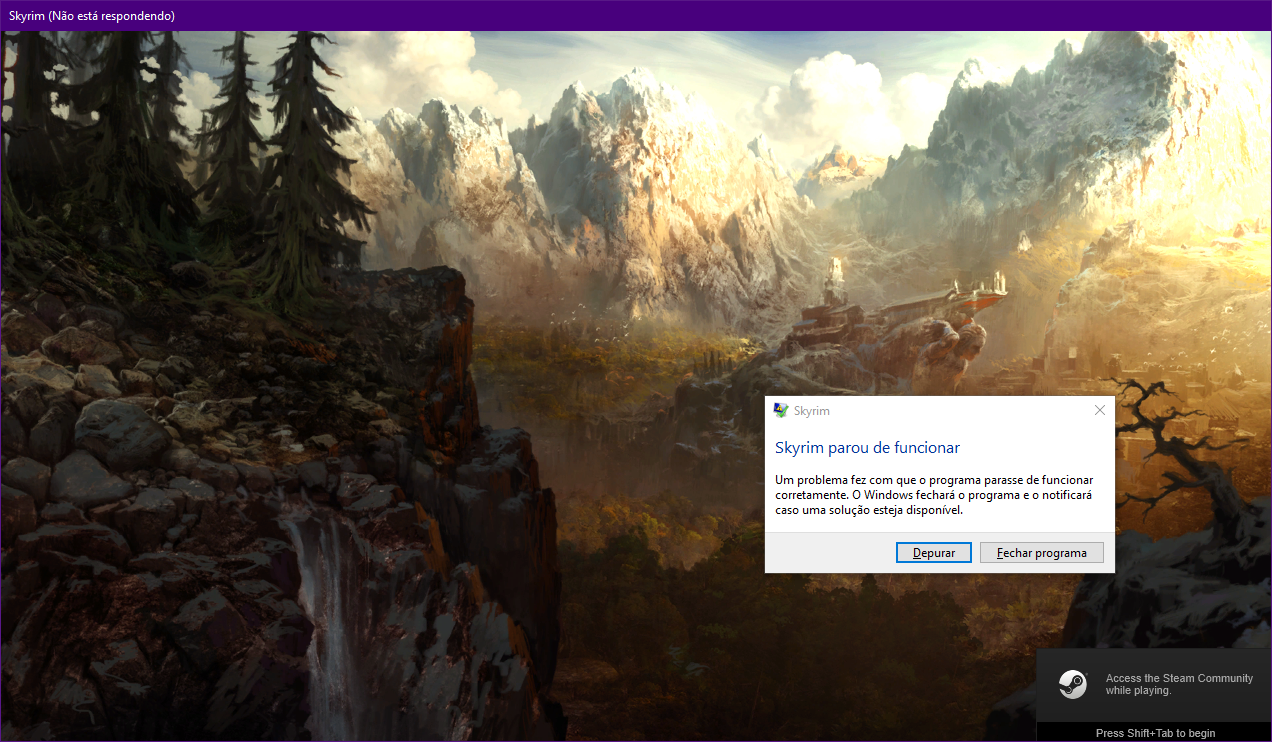

I tried activating some mods, and disabling them, still not able to open the game, can't even trie to load any save file, instantly crash. Tried activating Enhanced Blood Textures, same thing happened, not sure what to do next...
The windows says : Skyrim stopped working(its Portuguese, if anyone wats to google tradutor it), in a quick way.
Did you install SKSE separately? What a mistake would be. SKSE (not the newest version) is integrated in Enderal.

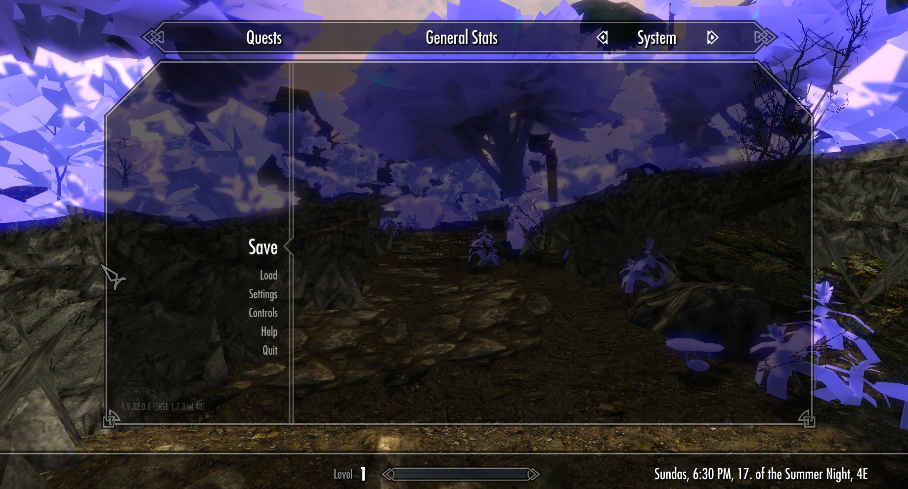

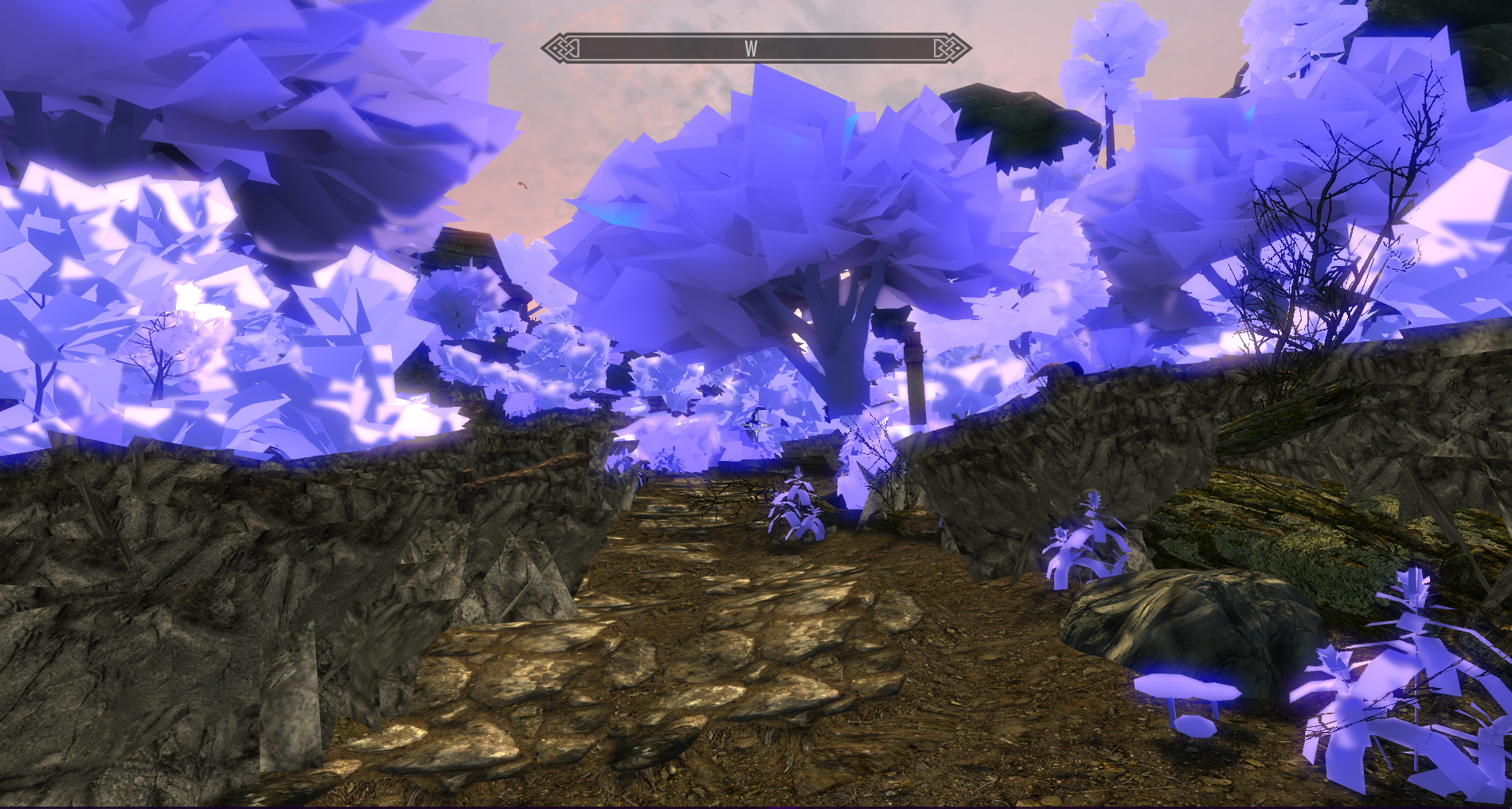

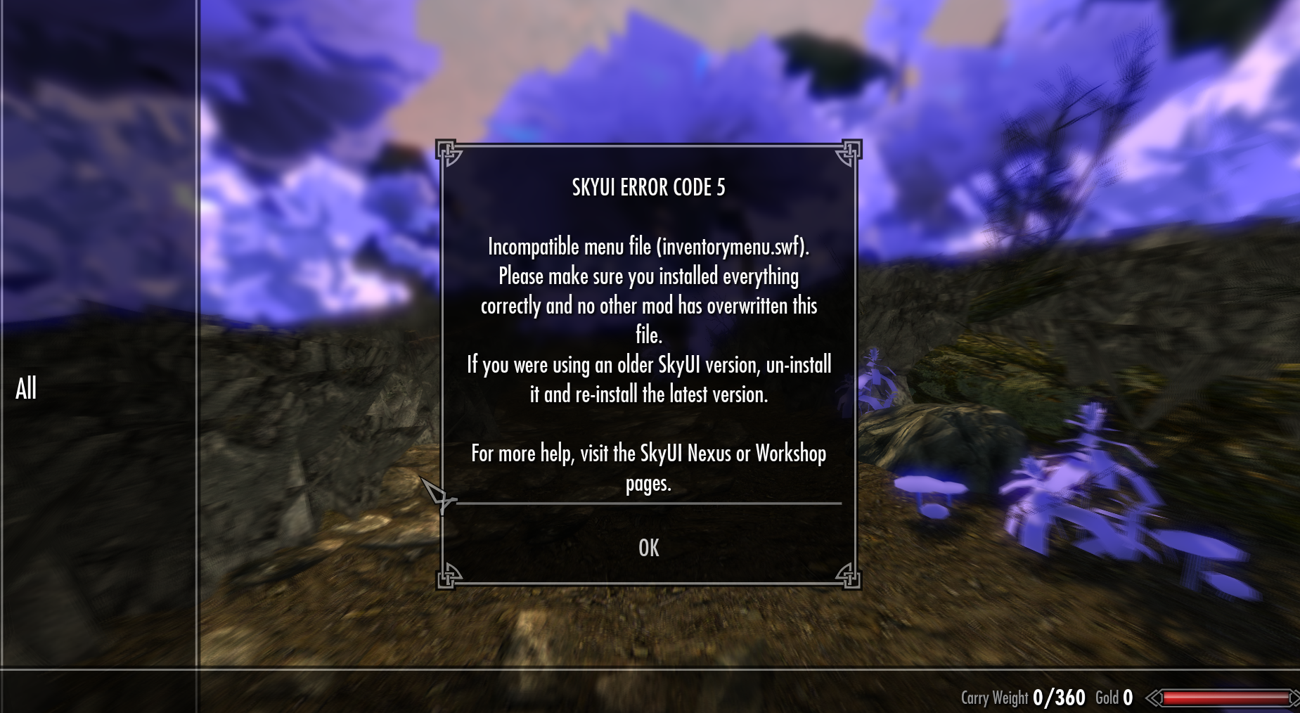

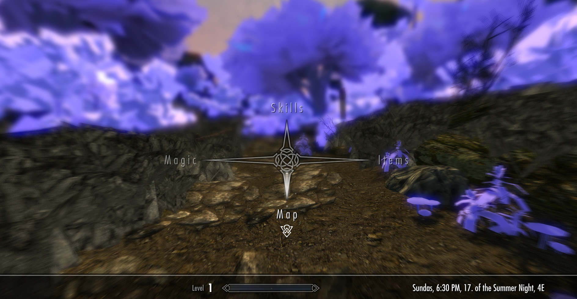

Another update, tried starting a new game,what happened, not sure?
also not sure
THe textures appear... well this
Part2
I believe its wronng
This appears for menus,help

- we had that texture issue just yesterday;
it's marked as solved, though I'm not entirely sure what solved it :/
it was most likely a corrupted install file
