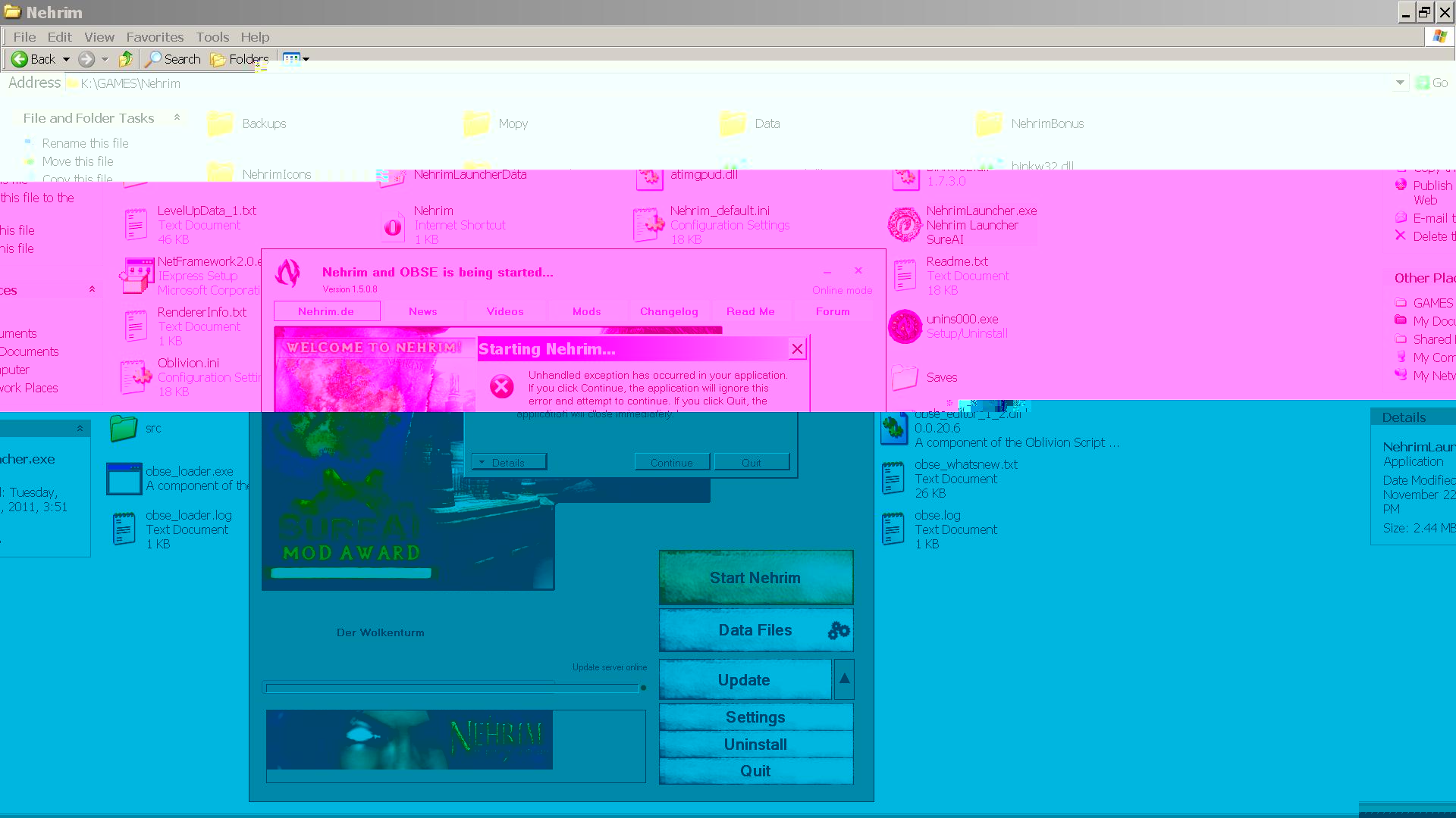

Just when I thought it was safe from the wierdness, I'm back to NO launch today after playing 6 hours yest with zero problems. And after 3-4 hrs today, got a CTD and now nada.
I found I cannot start from the OSBE loader, from the "Start Nehrin" button in the launcher or from the Oblivion.exe (which is what my shortcut points to).
Tried installing and running NIE for the improved interface and it wouldn't show up even with the .esm in the data folder as directed.
Thinking this is my issue, but after un-ticking it in both Wrye and launcher data files, it makes no diff.
Guess I'll delete it and try, then restart rig and see.
Wish I knew why I get the application error code on CTD and the unhandled exception fault with this.[*] This is all totally new after all the mods and maps I've played in other games.
It's gotta be an simple solution, heh?

OK, this is starting to drive me nutsy.
I removed the .esm for NIE and got the game started with the OBSE loader. But, when I went to load a previous save, I got the "...some elements used for this saved game have been removed. Do you still want to continue?" or something to that effect.
If I click YES, it displays a "file corrupted" message and then "return to game"; then it's right back at the load save screen.
If I start with launcher, here's what I encounter: This is right after the musical score plays for about a second, then in 3-4 more that is what pops up. If I hit continue, it just stays with the launcher window showing -Nehrim and OBSE is being started- but never does anything. If I click cancel it closes the launcher.
The only way to start is to use the Obliv.exe and play until it CTD, then restart my computer.
Really guys, I don't mean to beat a dead horse, but I haven't found anything yet to correct this. I want to finish the MQ, please point me to something to try. Maybe I got some files in the wrong place or something. Don't know at this point.

Gorin wrote:Well I run OBSE without any problems since it is a requirement of Nehrim Expanded.
I actually have no clue, what's wrong with your setup
As I said, I never use the Nehrim Launcher to start my game.
I directly run it from the OBSE Loader.exe.
And I have no plan what NIE is but I suggest that you shouldn't use Mods that probably never made for Nehrim.
Hm, why the hell do you have a saves folder and an Oblivion.INI in your game directory?
They should be in Documents\My Games\Oblivion.
Nehrim uses the same INI path as far as I know.

NIE is an improved or enhanced interface over on the mods page. It required OBSE and so I installed it and couldn't get it to work right.
Played about 2 hrs this morning with no issues starting with OB.exe.
Wierd.

S O.K., G
Maybe someone has had this occur to them and figured out a way to rectify it.
ITM I'll be content to finish "Hope at the End of the World" and go on to the next chapter.
If I do find a "cure", I'll post back.
I am really wanting to upgrade everything soon, and that just might be the ticket.

If you have trouble loading and saving savegames, make sure you haven't installed Nehrim into a windows protected folder (programs for example). Also don't expect Nehrim to run much better on better hardware. The problem is the engine code that, not matter how fast your computer is, will always run slow in some occasions.
Have fun with the last story chapter, it's great
...The problem is the engine code that, not matter how fast your computer is, will always run slow in some occasions.
I have played Far Cry 2 on high settings with zero issues. However, it uses the Dunia Engine which is optimized for dual processors.
I may make an atttempt to set Nehrim on 0 affinity and see if that clears some things up.
I think on maximum settings it will slow down even on a i7 3970k CPU. I believe that there are code parts where the engine waits for something (hard drive or just watiting for a fixed time), so any improvement in computing power will lead to close to zero performance improvement.
Well, I managed to finish "Hope @the end..." by restarting my rig after ctd and no launch from the OB.exe
I just can't understand what resets the game with a restart that allows me to re-launch????
Have tried doing the in game mem purge via the Diary, to no avail.
May next try console "pcb" command and see what diff that makes.
How does that apply to graphics cards? I was checking my fps at the L tomb where Arkt retired and standing still with no action I was only at 19.
Sucks fo sho.
... so any improvement in computing power will lead to close to zero performance improvement.
Sucks fo sho.
The fps will only be as high as the slowest component allowes them to. Unless you have a really old/weak graphics card (2008 and earlier), it shouldn't be the limiting factor for you.
Apparently the memory handling code is rather crappy in the Oblivion engine (one of the reasons why scripts often crash and cause problems). So I could imagine that after crashing, the memory isn't properly cleared and this somehow prevents the game from starting again. I'm not pretending to know exactly what's happening, but as we don't have acess to the engine code there isn't much we can do. Maybe, maybe a talented modder can patch the binary (Oblivion.exe) so that some of the code runs faster, similar to what someone did with skyrim. But honestly I doubt anyone would spend time on fixing a seven year old engine.
