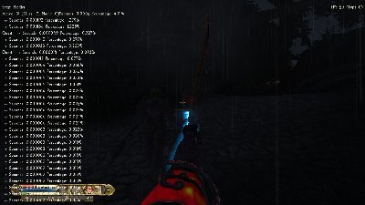

I was becoming irritated with low fps arround places like the Dark Forest and Erothin. Like so many I had started to mess with Nehrim launcher settings/ different software and tweaks and almost forgot my own belief of look inside the box and know whats there before looking outside it.
What I have done is easy, easy,easy. Not fully tested yet, in that I have only took a couple of save games and ran through the Dark Forest and Erothin.
All I have done is alter some settings in the video options. Hit esc while in game goto options then video.
Two settings I have tried, maybe some other settings suit you better. The first left distant land on, the second turned it off. Dark Forest on the first (two tiny stutters of 8fps for less than a second) ran through at appx avg 60fps, second setting appx avg 40fps.
All I have done within options/video is lower tree detail to 30 and visibility settings in order as follows , 20,5,20,25,70. Set last figure lower distant land turned off.(which would be best setting for Dark Forest, Erothin).
Do not believe me!!!!! Take a save game, type in tdt at consul and watch top right fps. Change settings and do again. No harm done. Tell me if wrong.

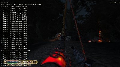

Below 2 pics in Dark Forest. First distant land off, second distant land on. Click to enlarge image.
Let me know how you get on. Love to make it so much more playable for you all.

Yes, I knew about the "trick" with distant land from some months back. What I am trying to show ( I hope some others try,just in case its how my pc is set ) is that by tweaking some other settings, which will not affect the rest of the game, certain areas which had a lot of stutters/ low fps will improve.
I think my communication/presentation skills lacking in my screenshots, I should have put one showing fps before tweaks. You will still get stutters no matter what, but you can improve overall playability. With distant land on and no tweaks, my game almost comes to a complete standstill, but make a few tweaks and it improved to the point where the only time it slowed to single fps was when I put in 2 dark elves throwing fireballs, a skeleton, a wolf and an acolyte attacking me. With distant land turned off plus the tweaks went through the fight at 25 to 30+ fps.
