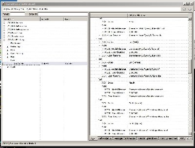

see Tes4edit below. Race I have half created, pinching bits from everywhere else.

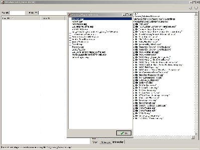

When you start TES4EDIT,what esm's and Esps is it showing you can load.
Enlarge screenshot below, shows what my TES4EDIT looks like at the start for my Nehrim install.
If Nehrim esm and esps are not there, you must check the guide on this forum for converting mods to see how to install Tes4Edit correctly. Tes4Edit needs a registry modification to work. Otherwise it looks in the Oblivion folder and not Nehrims.
