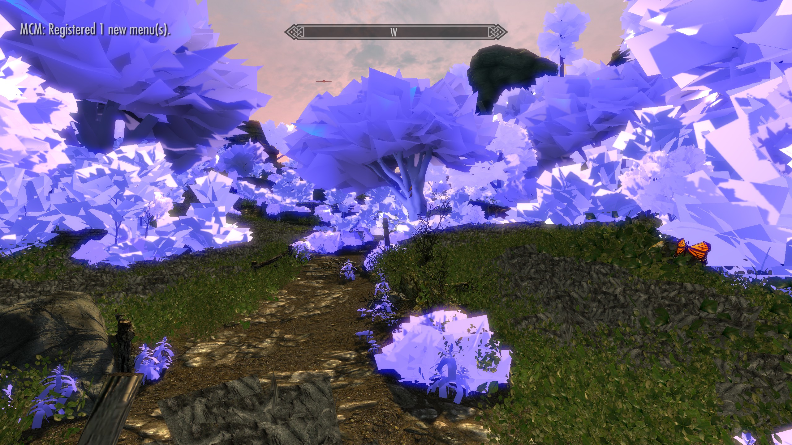

Next issue, I have erased all of my Skyrim files; saves, mods, old folders, to do a complete clean install of the game, but when I boot up Enderal there are broken and missing textures everywhere. I downloaded the mod from nexus and have verified that the launcher has no pending updates nor are there any mods I am subbed to on Steam, or have connected from Nexus.

This is what I see

Clarification, I did reinstall Skyrim before I attempted to install Enderal. The steps I took were; install Skyrim, move the install file for Enderal to the Skyrim directory ( I do have Skyrim on a different drive than the C:/ drive), Ran the Endral installer and after it was done patching I ran the updater. I restarted my computer after I did all these steps and still got the missing textures.
After I uninstalled I looked through my entire computer directory and deleted everything pertaining to Skyrim, Mods, Nexus Mods, and ENBs. The only mods I have left on my drives is for the Fallout Series.
I deleted the suggested files in the My Documents and reran the game, but still had the missing textures.

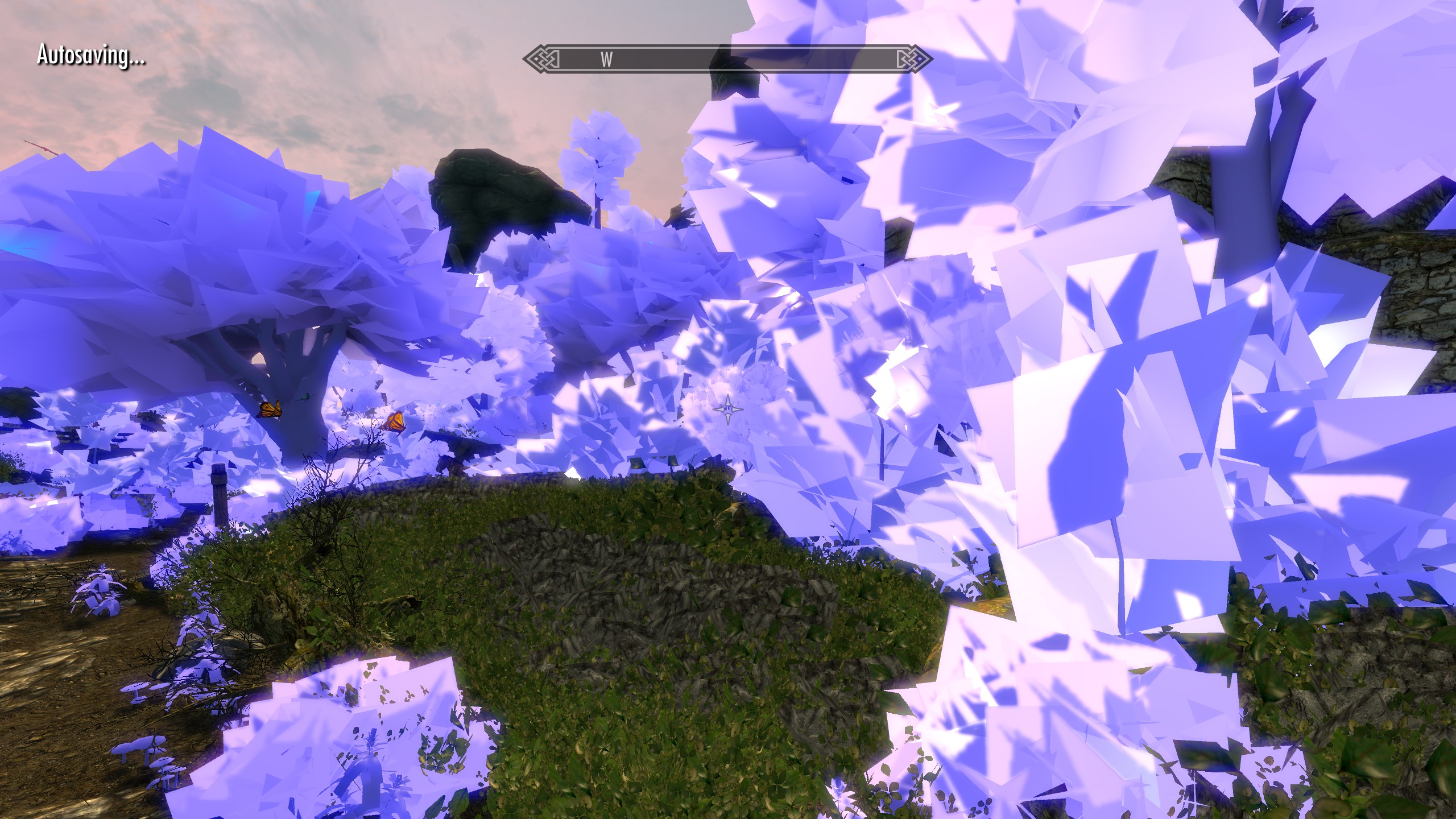

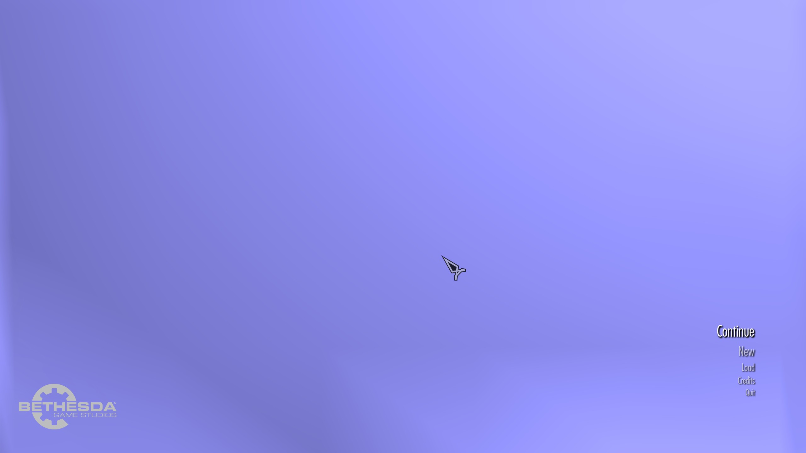

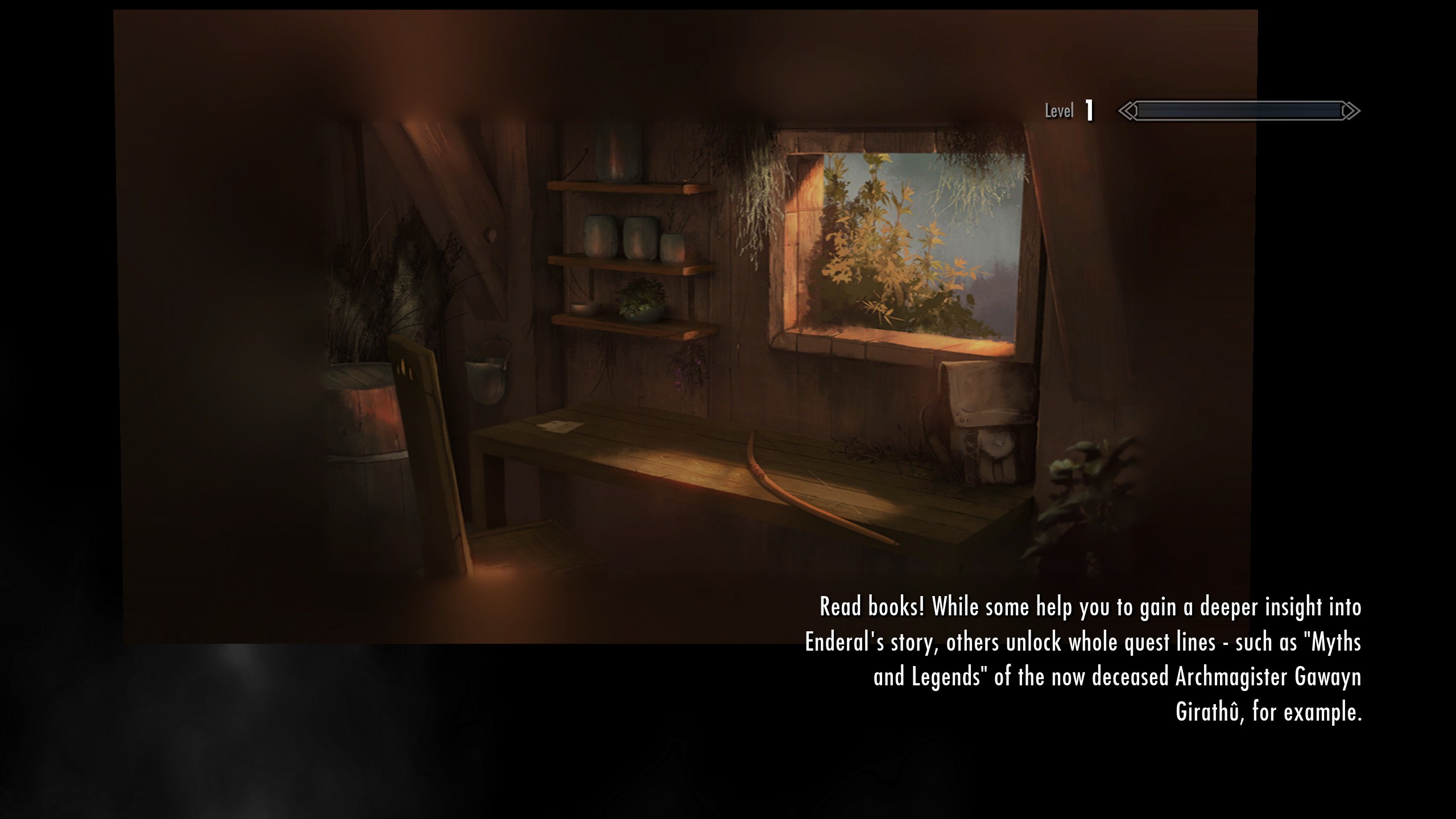

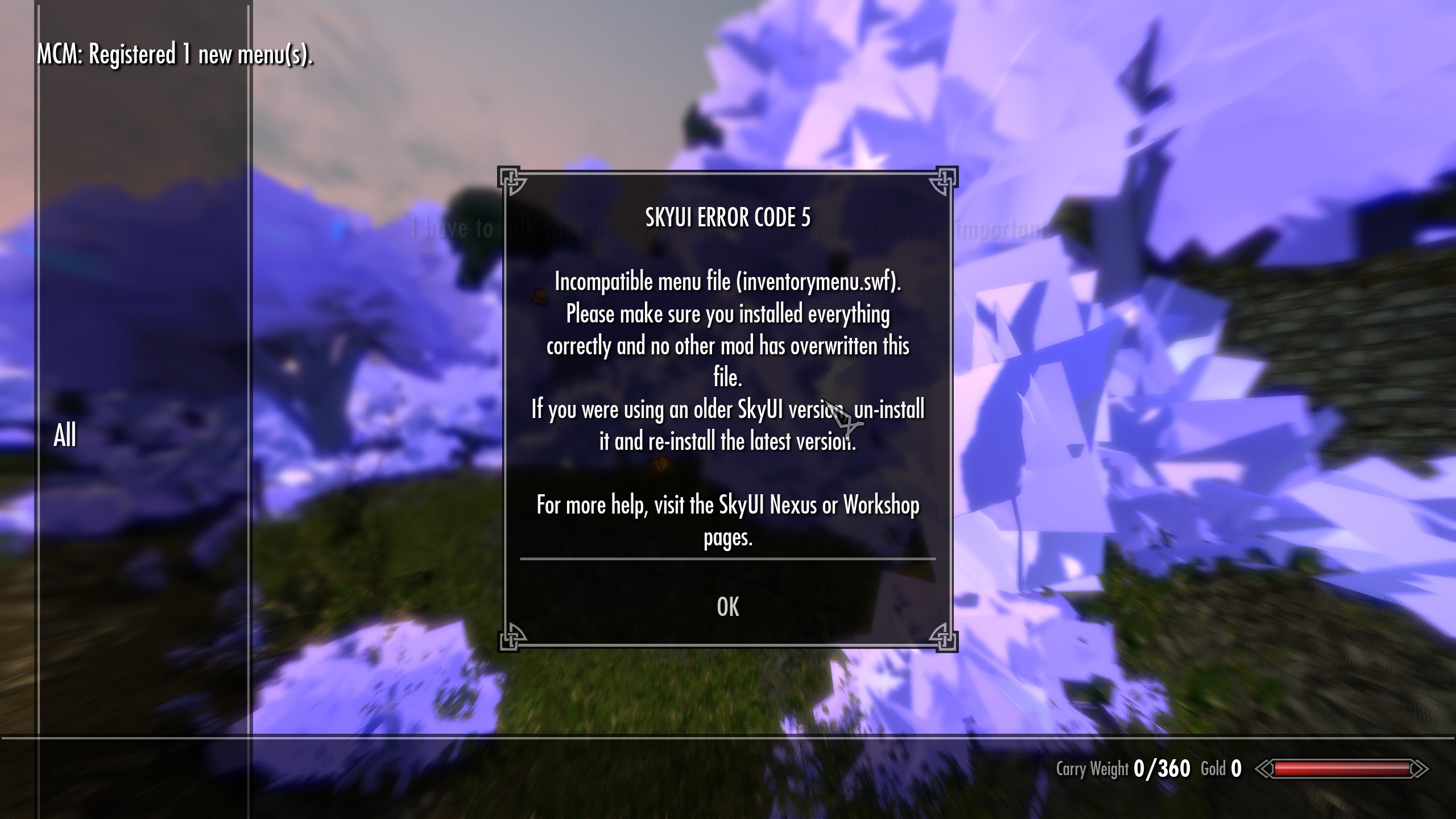

I have attached the requested file as well as screen shots of what I see when I start the game, loading, game start, and when I access the inventory.
I am gonna re download the 8gb install file and see if the one I got from Nexus is corrupt or broken.

Here are the other 2 since three attachments are the max.
hm,there is stuff missing in your ini, but nothing that would explain something like that.
corrupt download file is a solid guess :/
