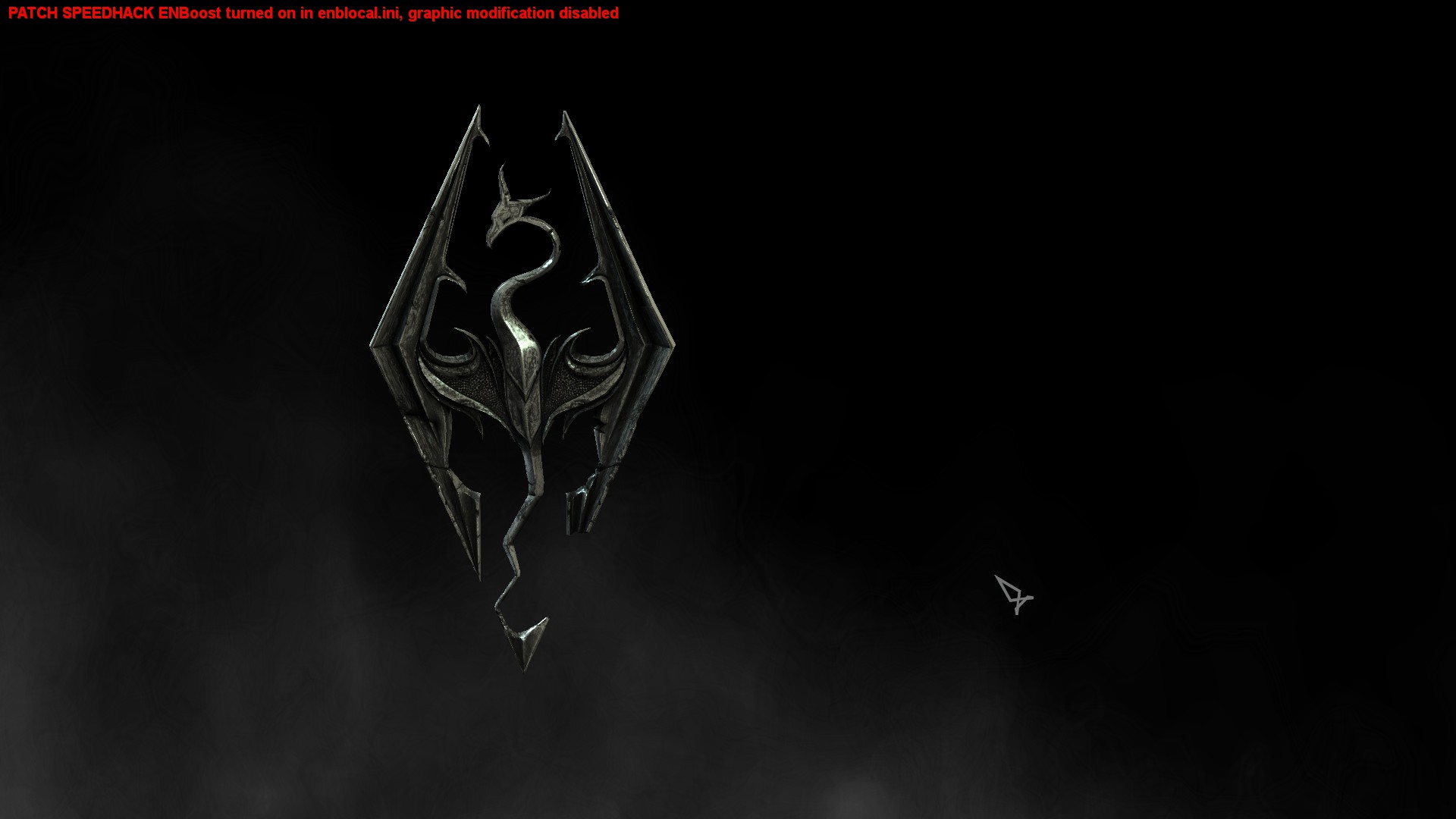

Hi, I just installed Enderal through steam for the first time. When I click New Game, the buttons all disappear and I'm left with the background art. My issue sounded a lot like the one detailed here but the solution of having my paths corrected did not help because they were already correct. I also hear music during the freeze as well. Attached is my launcher log as well as a screenshot of the frozen main menu screen I have. I have tried playing with the resolutions but that hasn't worked. This is a fresh install of Skyrim without any mods.

hi, welcome to the forum
please delete the Enderal.ini from (...\Documents\My Games\Enderal);
the game will create a new one on launch. try to restart the game.
if that doesn't work -
do you use a Mod Manager (and profiles) that might interfere with these *.ini files?
or is there a write protection on these files? (deactivate it)
could you attach the SkyrimRedirector.log from ...\Data/SKSE/Plugins/, please?
thank you
thank you
Yes thank you! After deleting Enderal.ini and starting up the game, I see everything. The art looks awesome thanks!
nice, good to know it worked - have fun playing
