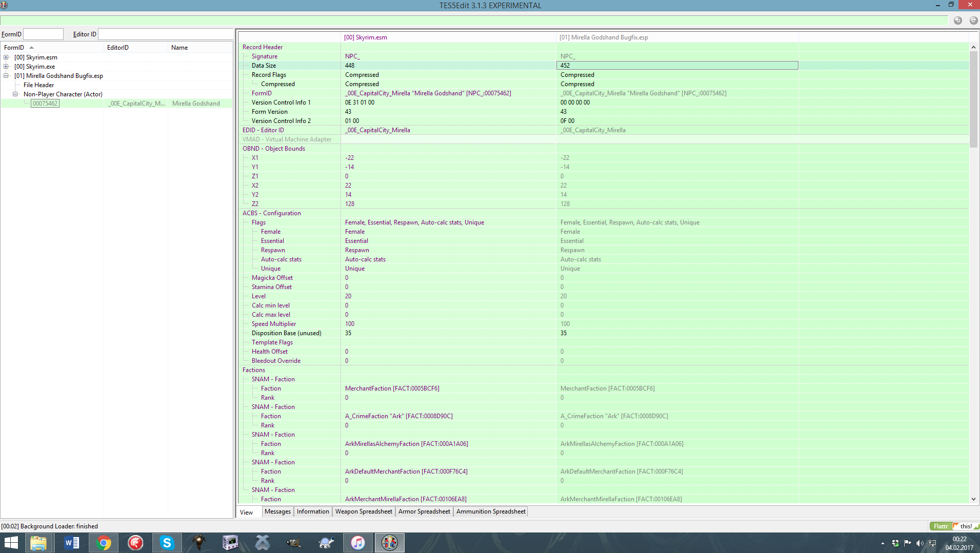

I have tested Tamira's Fix and apparently it fixes the problem. The odd thing is that it changes absolutely nothing on the game files. Tamira, have you changed anything that is not displayed in Tes5edit? The data size of the NPC changed...(might be a problem with the version control info..)
After a ton of testing and creating .esp files I figured out why this bug fix works and why the official patch does not. The order the factions are listed within the .esp file decides which faction wins conflicts between the faction records! The rule for breaking conflicts is the opposite of that for mods, with the faction listed first having the highest priority. Unfortunately, TES5EDIT will always list the factions in the order they appear within the Skyrim.esm file regardless of the order they appear within an individual .esp file. Even worse, the Creation Kit always displays and writes the factions in alphabetical order. Therefore, neither TES5EDIT nor CK can see the difference between the records for Mirella Godshand in Skyrim.esm and Mirella Godshand Bugfix.esp. The ONLY way I was able to see and modify the faction order and therefore the priority order of the factions was to use a Hex Editor and the zlib library to manually change the .esp files.
