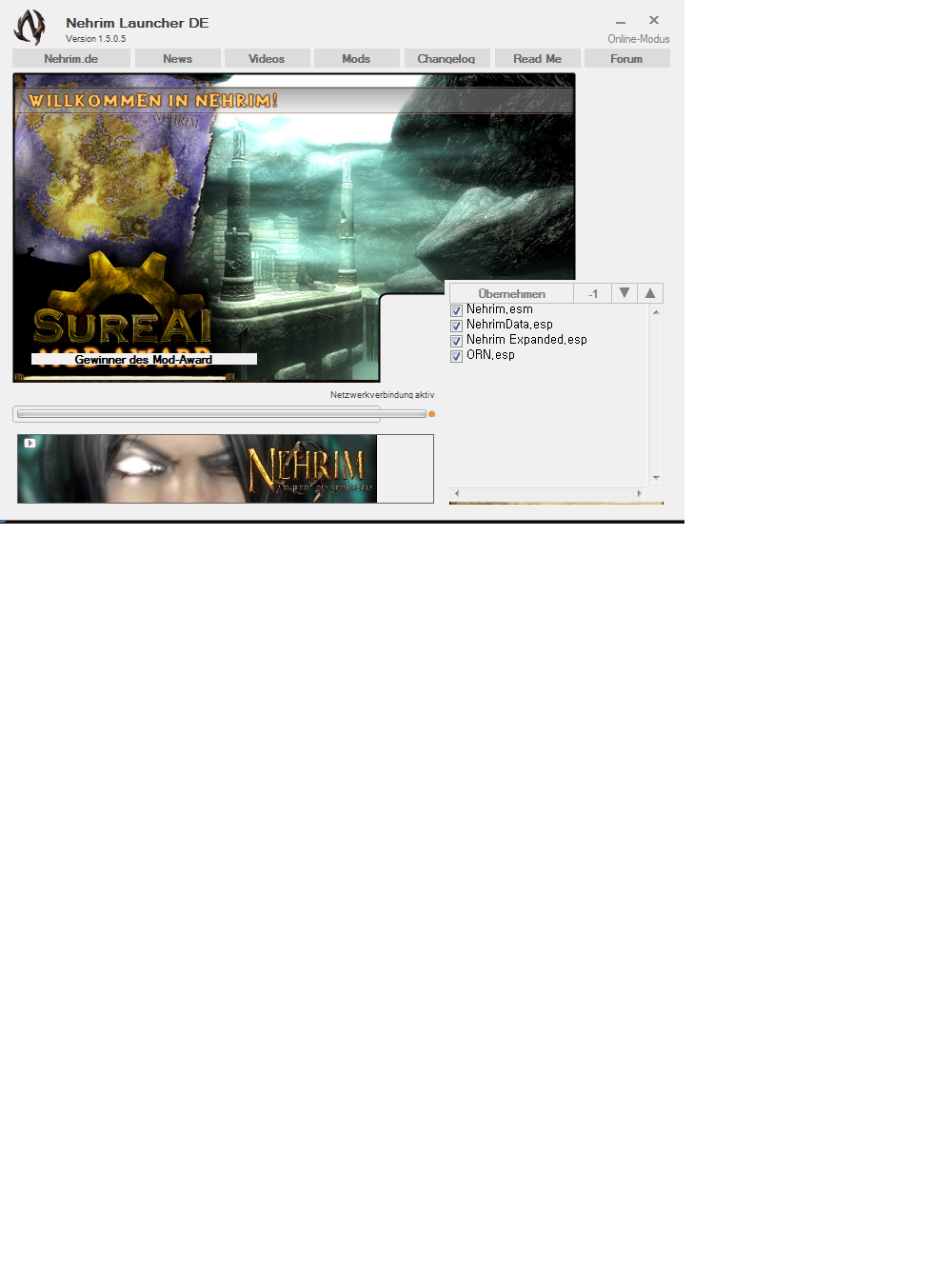

So, we clearly have a communication problem. I do not understand your problem completely. Is this a problem for all cats, or just this cat?
Also. In this post (https://forum.sureai.net/viewtopic.php? ... 997#p98997) the author tells you to not use ORN 2.0, which causes problems with body physics. Your cat problem is a problem with body physics. So - there is a conflict between Nehrim Expanded and your other MODS. It is not a problem with Nehrim.
BUT. Nehrim Expanded is a MOD, it is not an official part of Nehrim. The author is currently inactive, he is not there to help. This modification was made in German, and was never translated. You play it at your own risk.
I recommend the following - sorry, I do not understand if you have already tried it.
1) Delete everything.
2) Install Nehrim again. Install Nehrim Expanded. Only these two: Nehrim.esm and NE.esp (take a look at the screenshot)
3) Load your saves. Look for the problem.
4.1) The problem is gone - then you have a conflict with all the other mods, probably ORN.
OR
4.2) The problem is still there. Then the issue is with Nehrim Expanded only and not the Nehrim game - and with that, I cannot help you, sadly.
I personally do not use Nehrim Expanded. However, you can find it online, for example here: https://wiki.sureai.net/Nehrim:Nehrim_Expanded

Hi, nochmals! Das Forum ist klein, deutsch und englisch wird von den gleichen Leuten betrieben. Dieser Thread ist die deutsche Version vom gleichnamigen Thread im englishen Forum.
Wie schon gesagt: Nehrim Expanded und ORN sind Mods. Der Autor von Nehrim Expanded hat betont und Dir direkt gesagt, dass ORN mit NE nicht kompatibel sind. Du darfst sie nicht zusammen spielen, das führt zu Fehlern.
Ohne Mods sollte die Ladeliste nur Nehrim.esm und NehrimData.esp beinhalten. Das sind die einzigen Nehrim-Dateien. Also, bitte, versuche das:
1) Nehrim ohne Mods testen.
2) Nehrim nur mit Nehrim Expanded testen.
Sag Bescheid, wie es dann läuft! :)

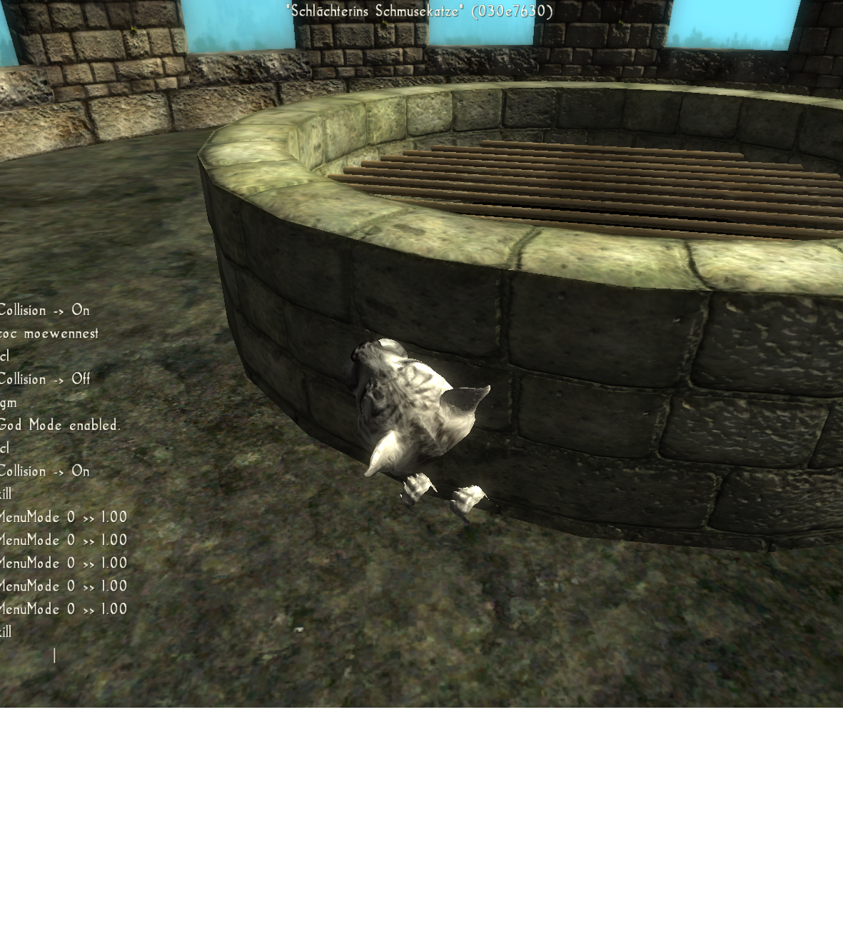

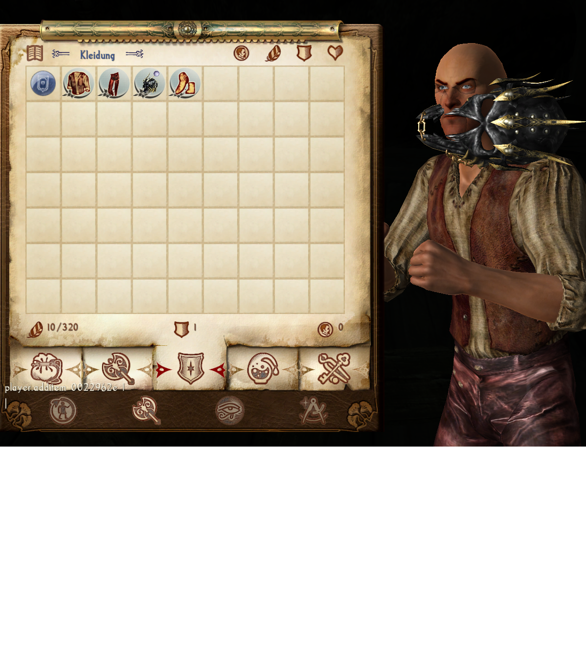

Ok, ORN is not causing the cat. But what about the helm?
About the cat: I would say this means Nehrim Expanded has a buggy cat. We are not the authors of Nehrim Expanded, it means we cannot really do anything. :( And the author is currently inactive.
