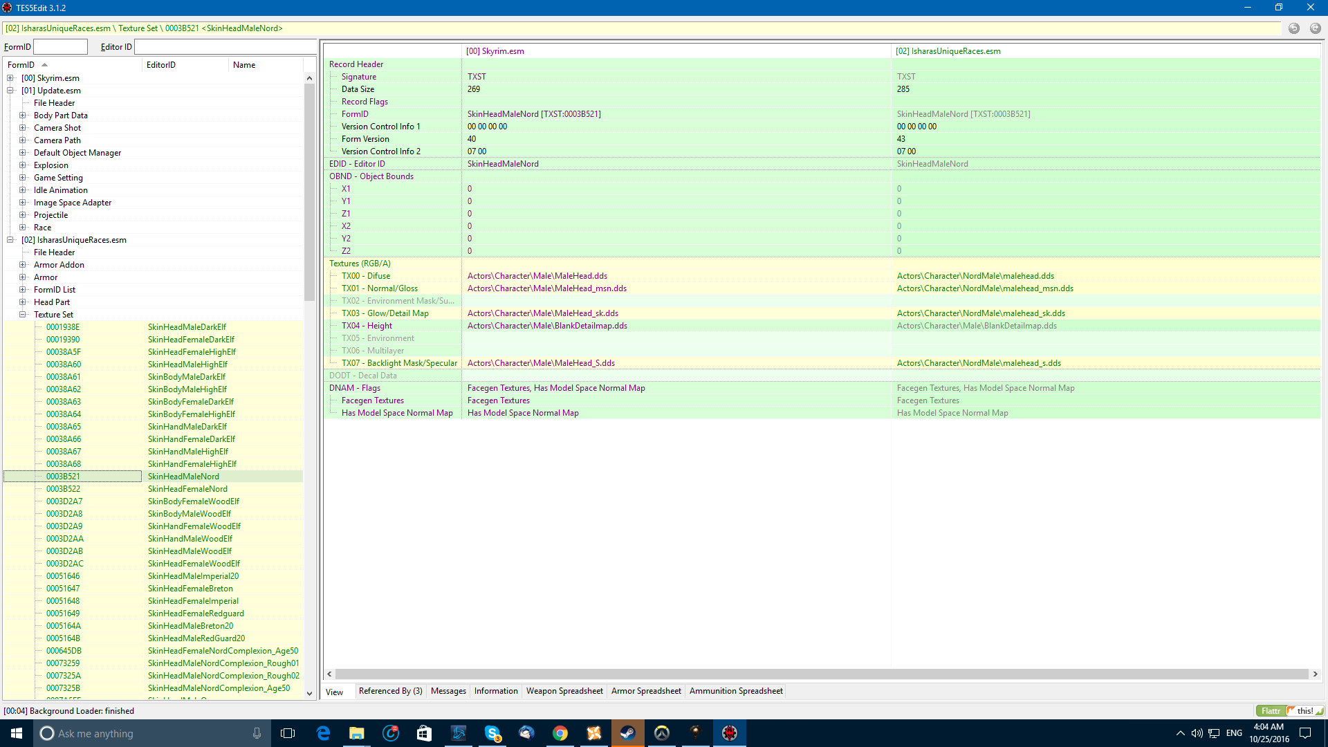

I downloaded the mod Enderal few days ago and I'm really in love with in and its
aesthetics ,I appreciate your hard work and effort into making it. I have a little problem
with one of my favorite races mods however, unique races which allows me to change the textures, meshes
and skeletons per race. The mod itself doesn't seem to have conflict with any of Enderal's files(only overrides
redirects textures/meshes directories of the skyrim.esm file to its own). The mod only works on the Breton race (Half Kilénian)
however other races use the default meshes and textures. I looked for hours in the TES5edit to see where the problem could be but I couldn't. The mod works fine on the vanilla game so I'm pretty sure that issue isn't with the races mod itself.
I even reinstalled the game, Enderal and the mod to end up with the same issue. Other unique race mods like unique everything or unique bodies don't work due to conflict in the race section. If anyone can help me I'd be grateful

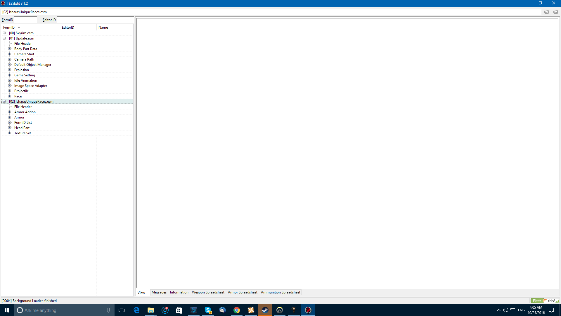

Adrenalyze hat geschrieben:Mods that edit race records are not compatible. Some edits might work with some trick & treat (trial and error) using TESV5Edit. If you have any conflicts try to resolve them by editing the racial modifier IDs, otherwise post the conflicting mismatch / error.Thank you kindly for the reply. I am well aware of the compatible mods list and the fact that mods that edit race records do not work. As you can see in the picture, the mod I'm using doesn't have any race records (nothing I'm aware of that is) . The textures/armor addon/armor override the original (skyrim.esm) without conflict according to TES5Edit. I know the mod isn't listed as compatible but I think If I can find the problem it could be. Maybe?

No race records: No conflicts:
